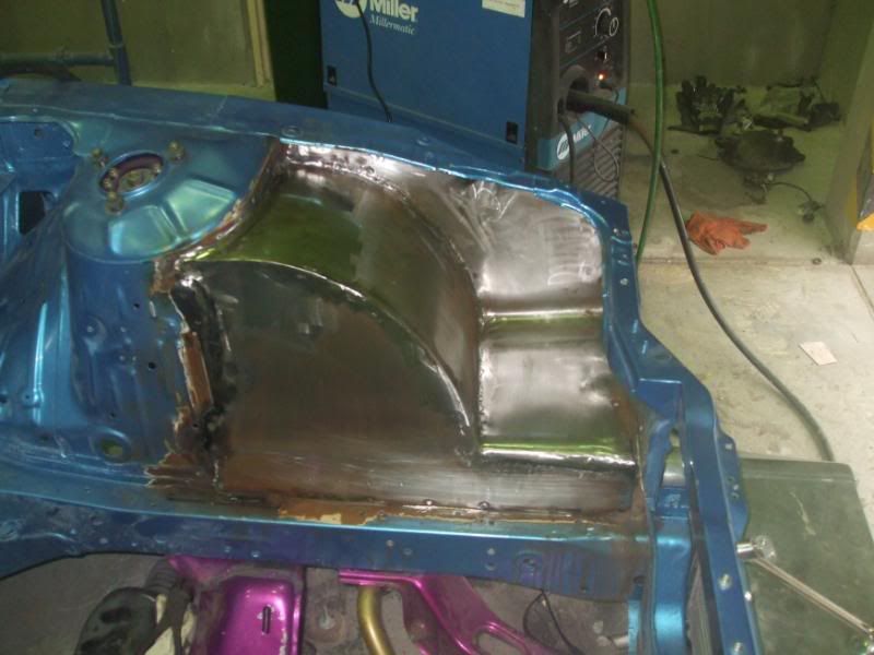

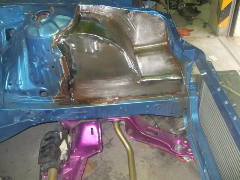

Update:

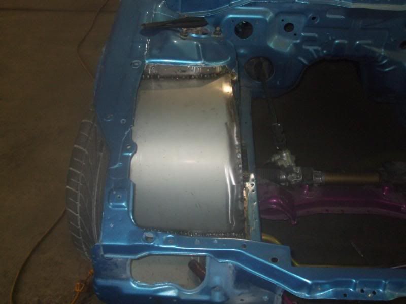

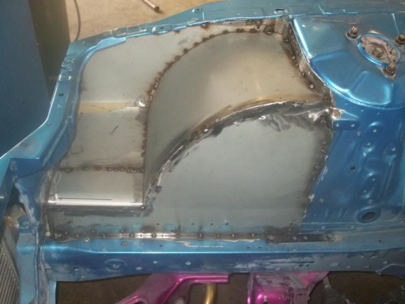

I decided to do wheel tubs and ditch all fo the fiberglass crap. Thanks to the guys in the fabrication thread for pointing me int he right direction. I Got most of the drivers side tub done this weekend. I still need to trim it up, grind a little, add a couple more welds and do some bondo work but all that is only a days worth the work anyways. Here are the pics. When it is all done everything will be nice and smooth without a metric shit ton of fiber, bondo, filler and other crap. The passenger side will be a little different as I will weld in joiner pipes for the intercooler piping and a couple other things, but all will pretty much be same same and hopefully all finished up by Sunday.

Nice job as always! I see you went all the way down to the frame rail. Did you put sheet on both sides like the factory or just one piece on the engine side? Or did you just use slightly thicker material? I need to take my tubs all the way down to the rail when i do mine so was just wondering how you did it.

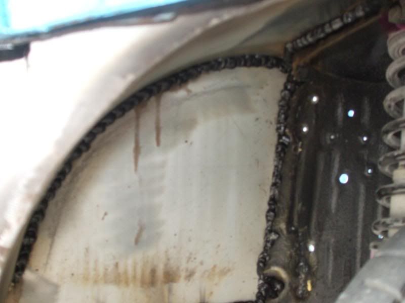

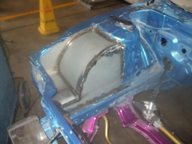

I left a little bit of the original metal vertical from the frame rail for me to weld to (About 2 inches). I also used 1.2mm sheet metal which is a little thicker than original. Littel bit of a bitch to work with but it is sturdy. Make sure you leve some tabs of stock metal to weld to all the way around. The fab thread in the tech section answered my questions with a shit load of pictures and how to's so you should look int hat thread before you do too much.

Cool thanks. I've been following that thread. It's gotten kinda big with some great work. I'll have a look through again.
=) hehe you're welcome, i'm glad Jesse actually took pictures of him doing the process so I could re-post them on every forum he doesn't visit lol.

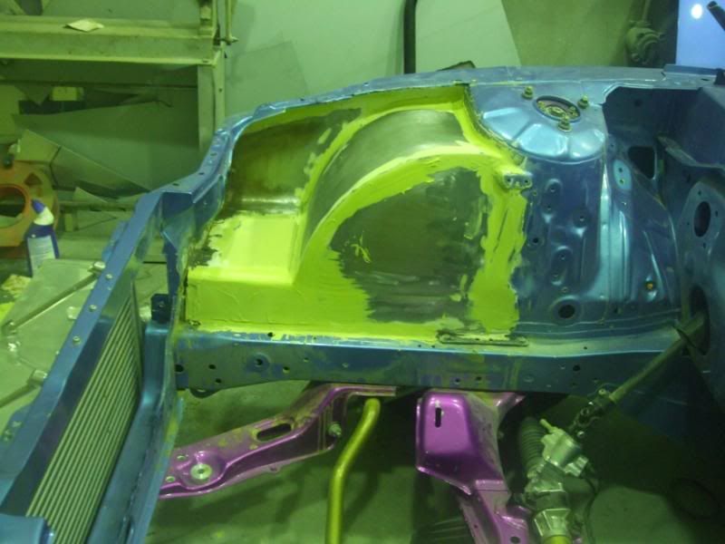

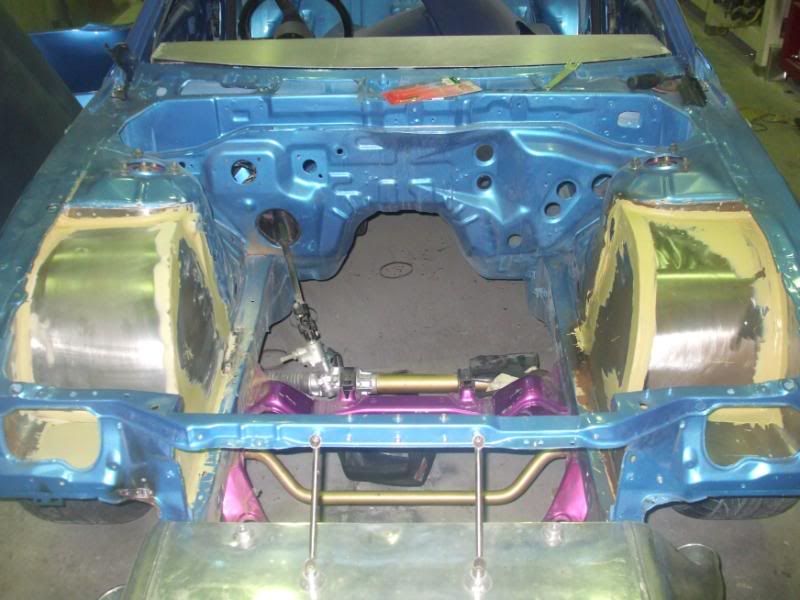

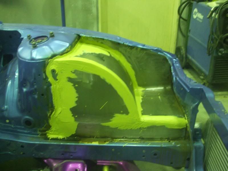

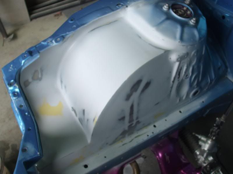

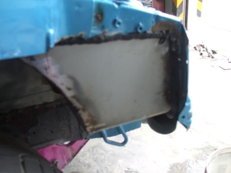

Got the Wheel tubs all set up and Bondo laid down. I will sand the shit out of it over the few days and then repaint the engine bay. Looks Like I might actually be on schedule kind of sort of with this one. I did not take pictures yet, but I used Body Caulk and sealed up all of the seams within the wells themselves to prevent rust and will go ahead do undercoating as soon as everything is complete.
Also, I am working possibly getting a deal on a HKS Dog box with modified transfer and triple plate clutch. If it goes through, the transmission issue is solved.
CursedGTR is offline

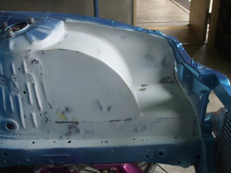

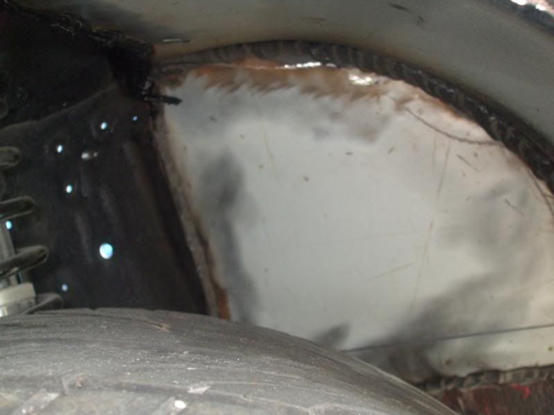

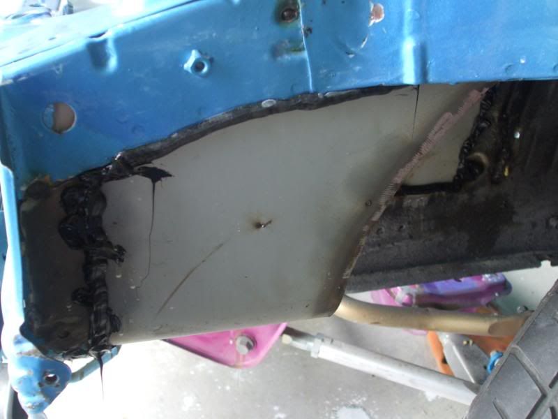

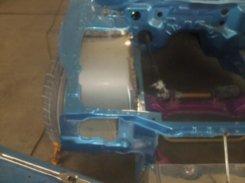

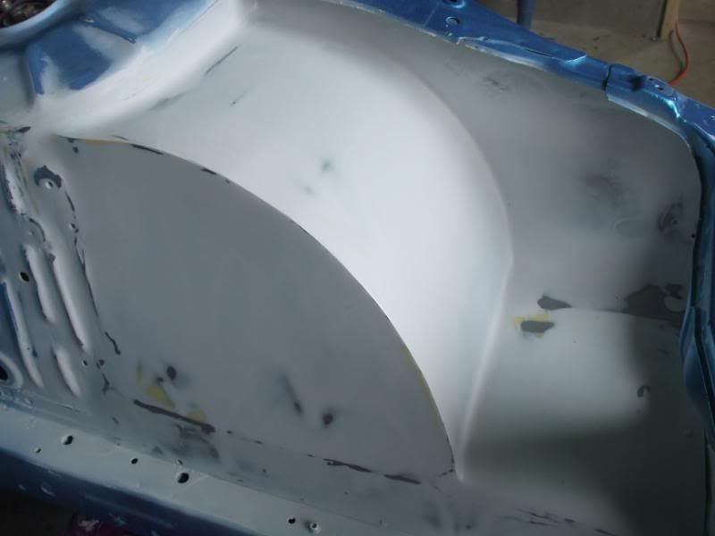

Wheel Tubs are ready for some paint. A little wet sanding throughout the engine bay and I am good to go for paint in about one week. I also have to do body caulk between the core support and the tubs, although wleded in, I made it possible to replace the core support by using a drill and a grinder to remove it. The body caulk will help keep crap and wet shit out of there.
Originally I was going to 70mm - 80mm transition/joiner pipes welded into the new sheet metal for the intercooler piping on the hot side to connect to, but I discovered that the size is a little too much and would interfere with the frame rail, so Now I am going to either make a 70mm oval slot or two 80mm holes, just haven't decided yet, but then again, I don't need to any time soon.
I used black paintable body caulk to seal up all of the seams inside of the wheel well, next I will hit it up with some undercoating and call it finished under there.

Posts: 9,135

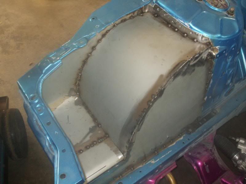

Great job on the tubs! After just doing this myself, I can say that yours are probably the perfect size. Bondo helps with the look soooooo much.
